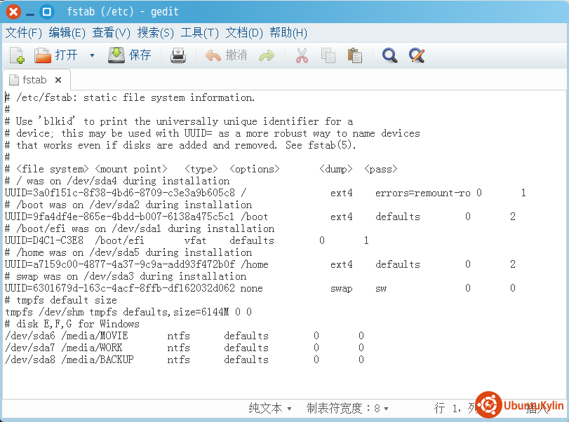

在fstab文件末尾加入:
disk E,F,G for Windows
/dev/sda6 /media/MOVIE ntfs defaults 0 0
/dev/sda7 /media/WORK ntfs defaults 0 0
/dev/sda8 /media/BACKUP ntfs defaults 0 0
效果:
/etc/fstab: static file system information.
Use ‘blkid’ to print the universally unique identifier for a
device; this may be used with UUID= as a more robust way to name devices
that works even if disks are added and removed. See fstab(5).
/ was on /dev/sda3 during installation
UUID=900728b3-b933-48db-a9ee-63137c73ff40 / ext4 errors=remount-ro 0 1
/boot was on /dev/sda2 during installation
UUID=d3c915a1-a2c9-4a03-82ba-f7e054cdc623 /boot ext4 defaults 0 2
/boot/efi was on /dev/sda1 during installation
UUID=9AB3-5FB5 /boot/efi vfat defaults 0 1
/home was on /dev/sda5 during installation
UUID=dfc732f2-5e91-42e3-b987-e9b9ec436dd8 /home ext4 defaults 0 2
swap was on /dev/sda4 during installation
UUID=9ea7169e-10a1-4ea7-9a5d-dd63858cae0b none swap sw 0 0
tmpfs /dev/shm tmpfs defaults,size=6144M 0 0

附上我的修改后的fstab文件图片供你参考:

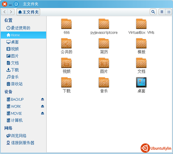

重启后自动挂载效果图如下:
